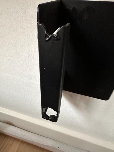

BRONZE MemberI had to put electrical tape on the wall bracket to fix rattling. The metal to metal contact would rattle when playing loud low frequencies (like the room calibration boops). All is good now.
6 December 2022 at 19:17 #37751Sandyb
BRONZE Memberyou’re not the first – a few people over on the Discord side have had to do the same.
