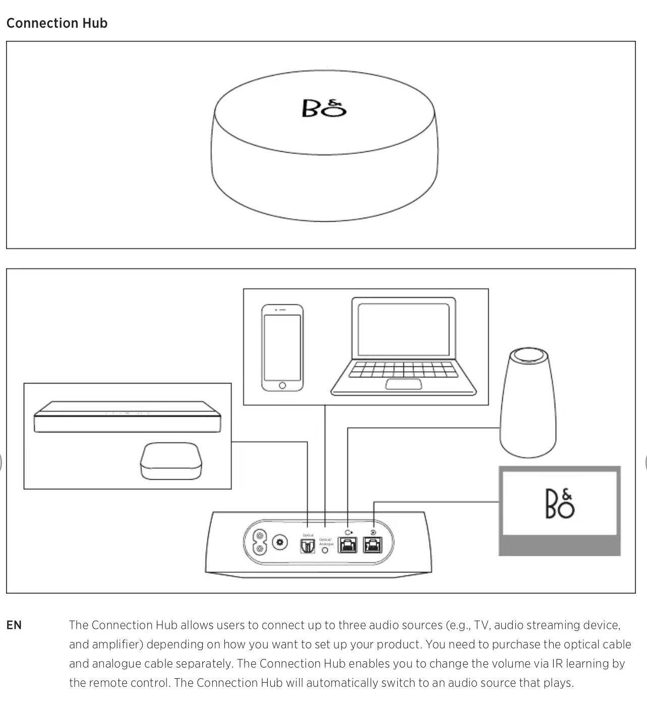

    With this hub you have different options – see this picture:
    This means that you can connect different audio sources there (only one will play, the other must be turnded off).
    You could use the optical in for the sound from a 3rd party tv (that is maybe what you do now).
    And use the Powerlink input for the BC2.
    In this case there would be no speakers connected to the BC2 itself, but to the hub….these could be the 5’s.
    This way you’d have sound from CD, streaming device and tv using the same pair of speakers.
    Enjoy ?

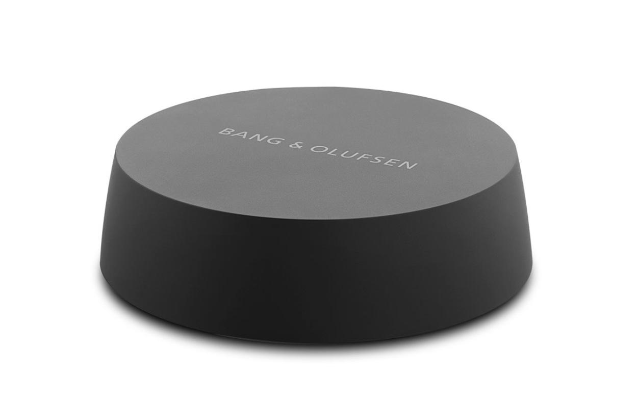

    Furthermore I did ask you about, what you call a Core (mentioned again under 2.) That seemed to me to be a BeoPlay Connection Hub.
    I did post a picture with information about that earlier.
    Sadly you did not comfirm, what device it actually is, that you have.
    The Core looks like this….
    …..and that is not the device in the photo, you posted earlier on.
    It is a different kind of device – for another purpose.

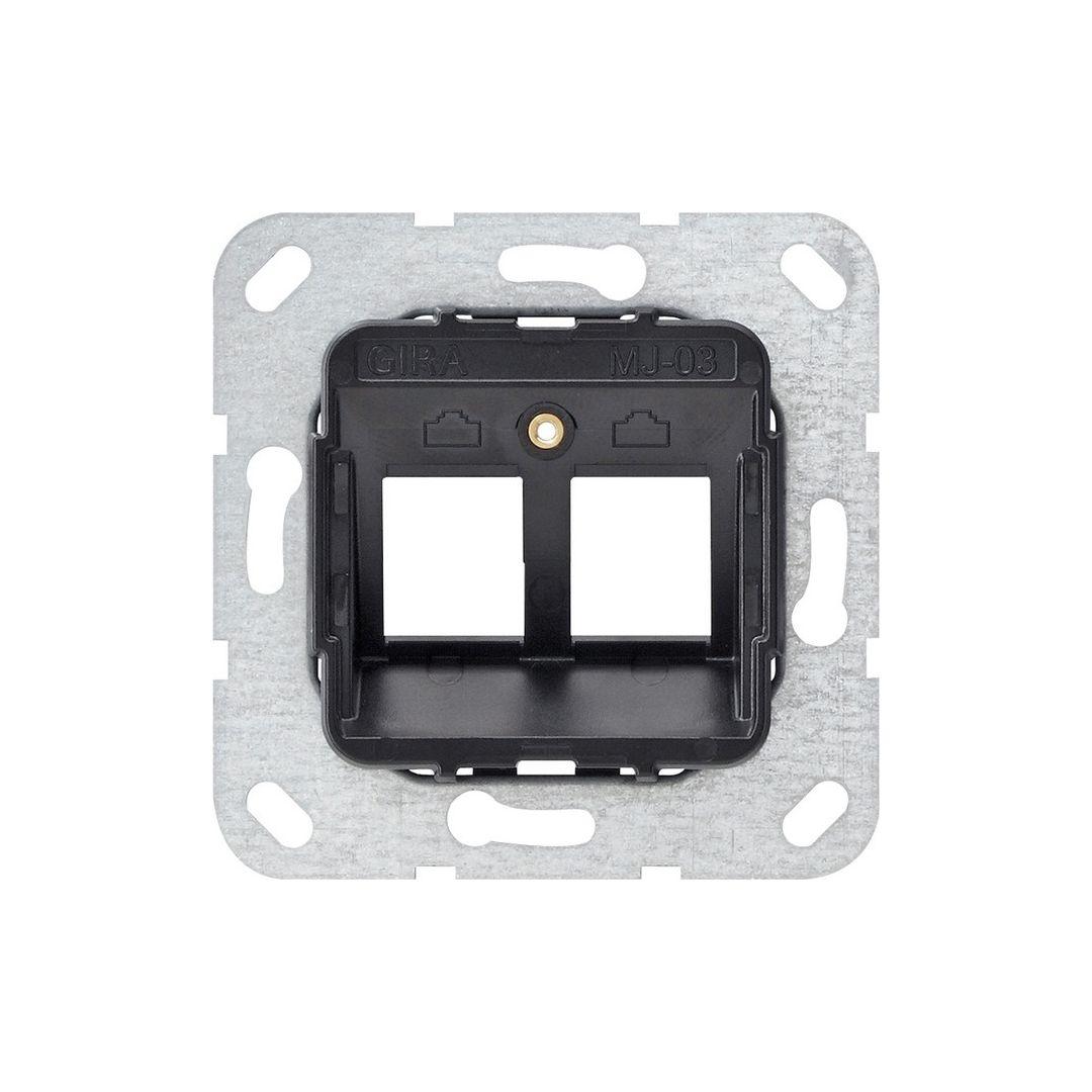

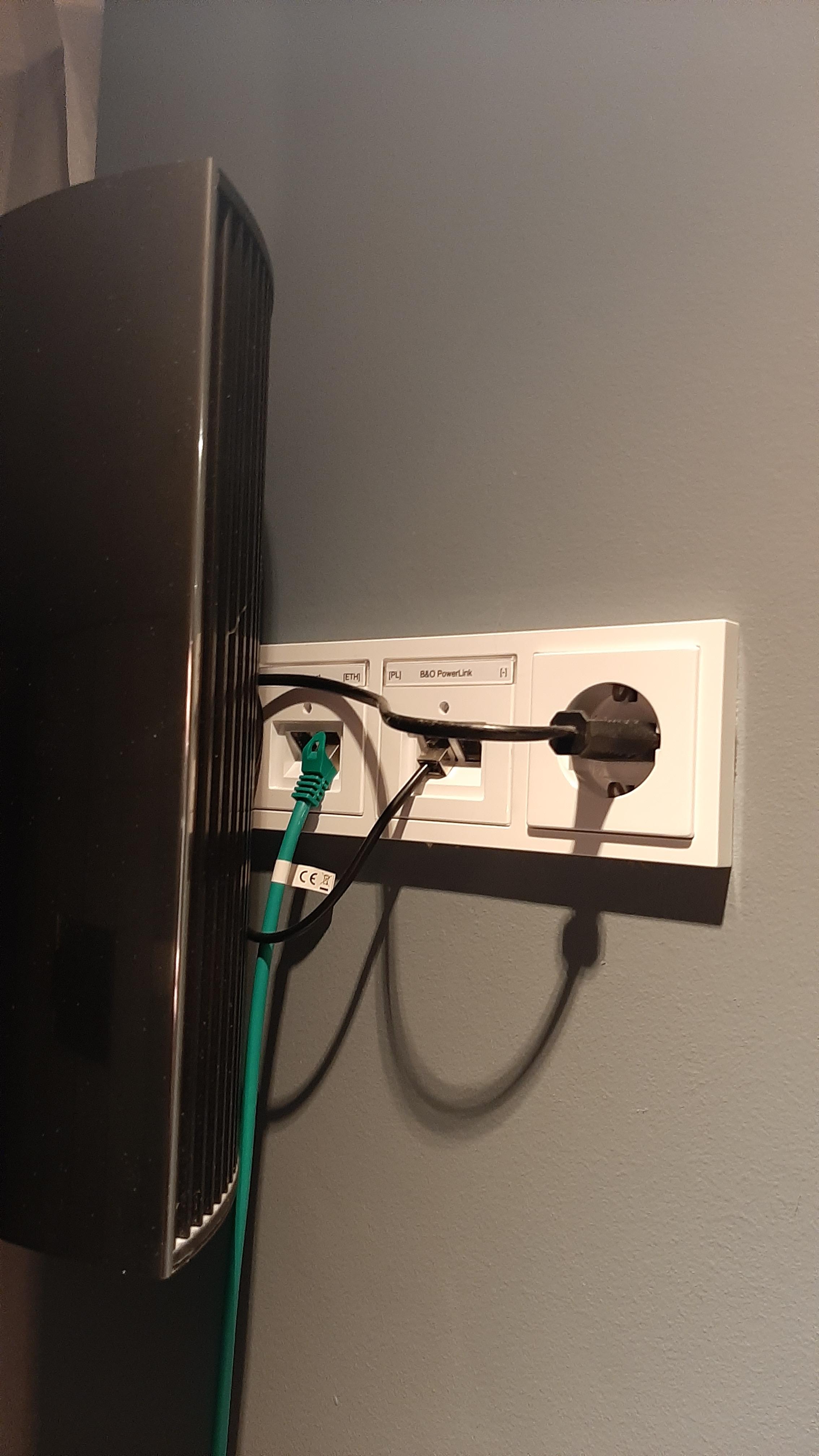

    You can run either PowerLink, Masterlink or Network Link over regular in wall Cat7 S/FTP solid wire ethernet cables. Check also the handbooks mentioned top right on this site.
    You can terminate such cables using RJ45 keystones in standard wall (or floor) outlets at all places where you need such a connection. And only there use an adapter cable (when needed), like an off the shelf RJ45 to 8pin DIN (for BL3 or BL9) or custommade RJ45 to ML for the BS9000. You could even make custom RJ45 to mini jack adapter cables for the BL5 volume syncing connection if at all needed. This would mean that you can install very standard cabling, but use it very specifically for your (heritage) B&O equipment. The other advantage is that normal diameter tubing can be used as you do not need to pull (large) connectors through them. Normally the wall outlets (at least here in the Netherlands) can hold 2 tubes and two keystones each, the mounting plate for the keystones looking like this:
    Apart from the mini jack cables I use all of the above connections. Example of the kitchen BL4000:
    For the digital coax connection to the BL5s there are S/PDIF coax keystones too, allowing to pull coax cables without connectors. Again standard cabling.

    Please see added images attached of how I currently connect my BL3 to a LG tv– it works fine.  It is round but the has B+O on top not “Bang and Olufsen”. I thought this was the “Core”?
