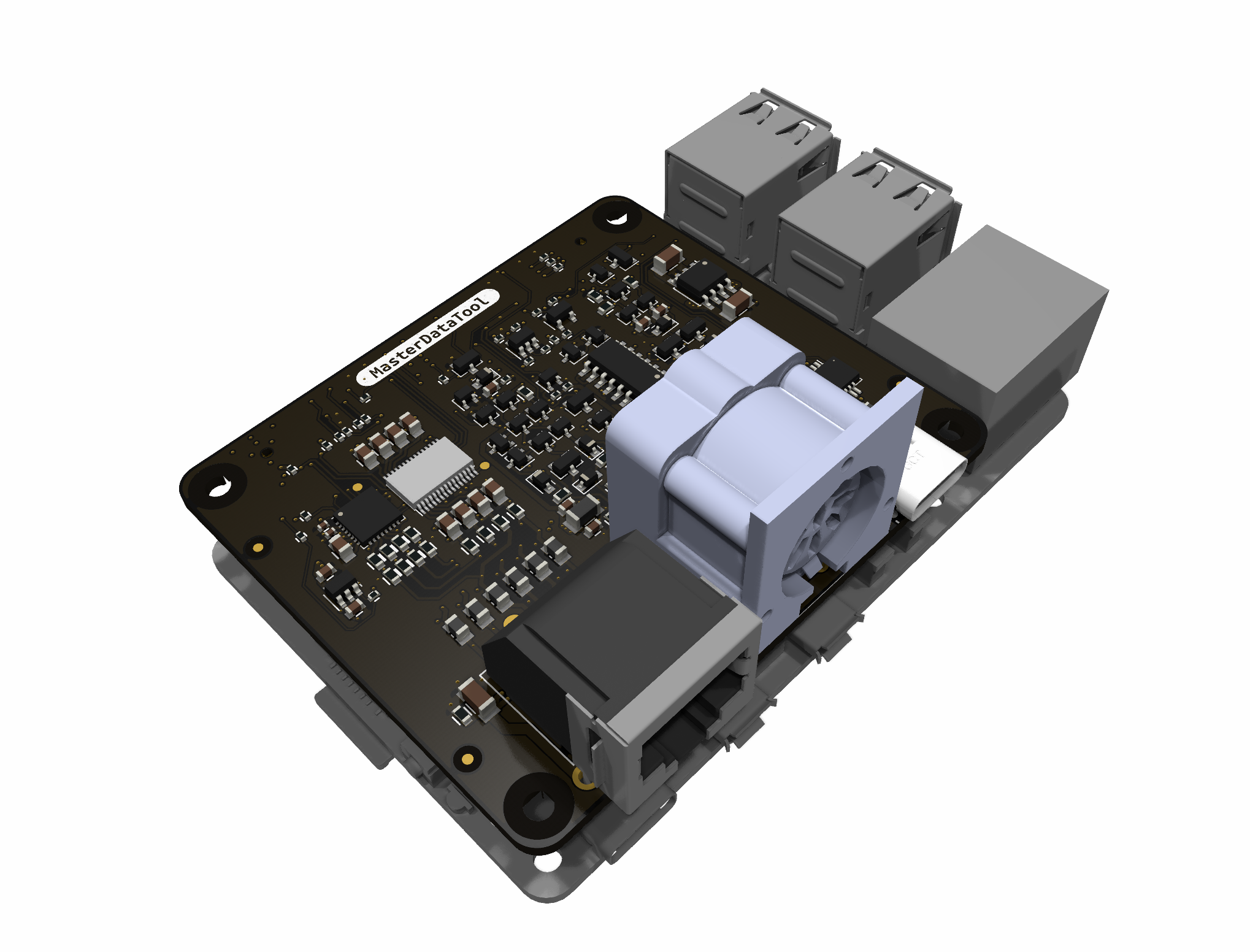

    Went ahead and slightly changed the architecture. It now has the form factor to directly fit on single-board-computers with the common 40 way pin header. Raspberry Pi being the most known one. It also reduces the cost a little as no USB-audio converter is needed. Board is finished so far. Will order a few samples in the coming days. Not expecting major issues as the circuit itself is already know to work.
    A rendering of the current shape. There was a little space left so I added Datalink as well. Hence “MasterDataTool”.

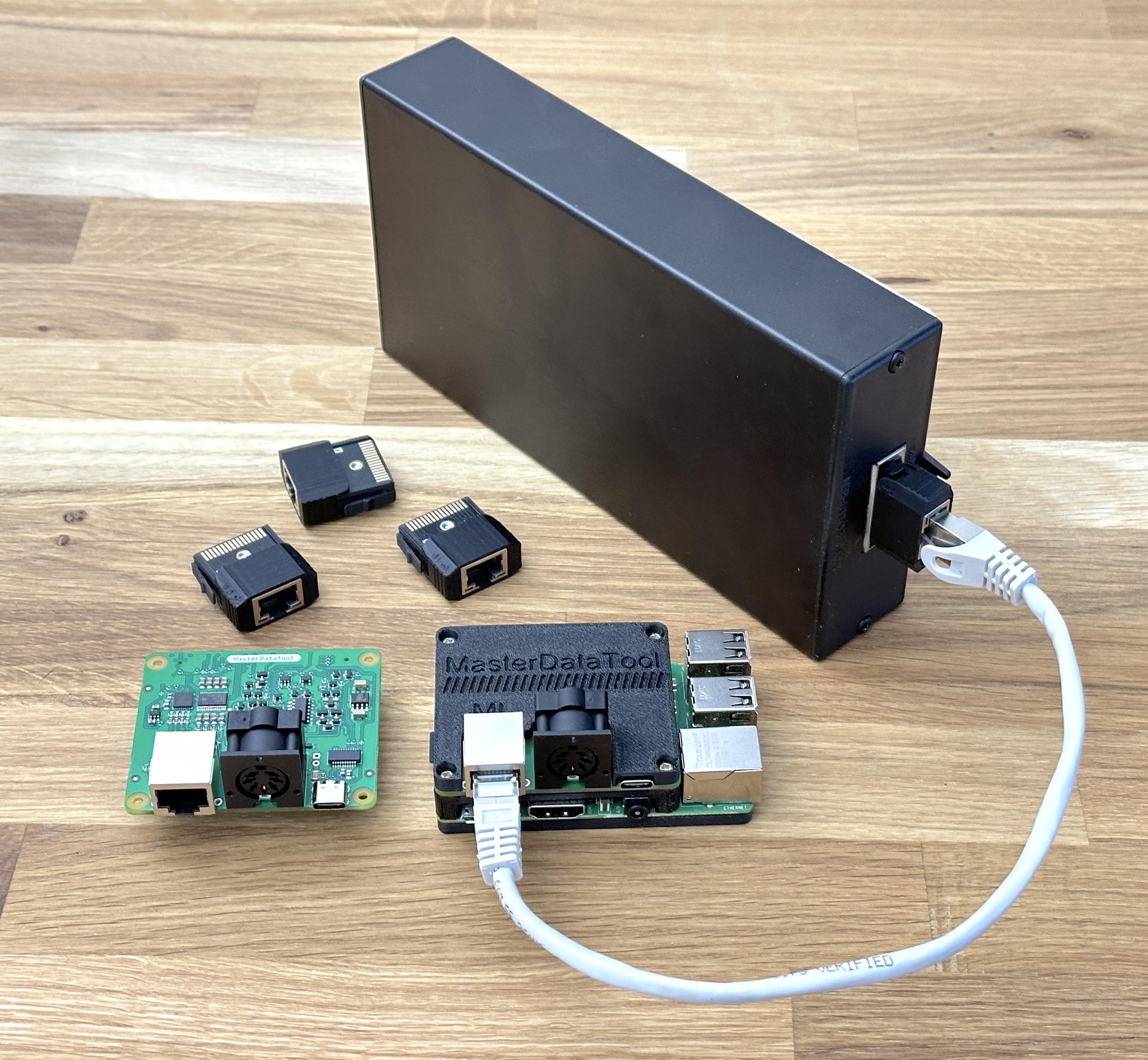

    Short update here. PCBs arrived and so far everything works as expected.
    Also put together a very basic “housing”. Actually just a few small 3d printed plastic parts covering the electronics. The intention is really to not make it a fully polished product. Instead something fun to tinker with and financially also matching the current market value of other ML and DL equipped devices.
    Will use a bit of the Christmas time to refactor the software a little and maybe also do a few videos of cool things one could do with the MasterDataTool.
    For people not recognising the larger black box in the picture. It’s a BL Video converter and not actually part of that project. Just needed something with a ML socket and that fits in the picture… 😉

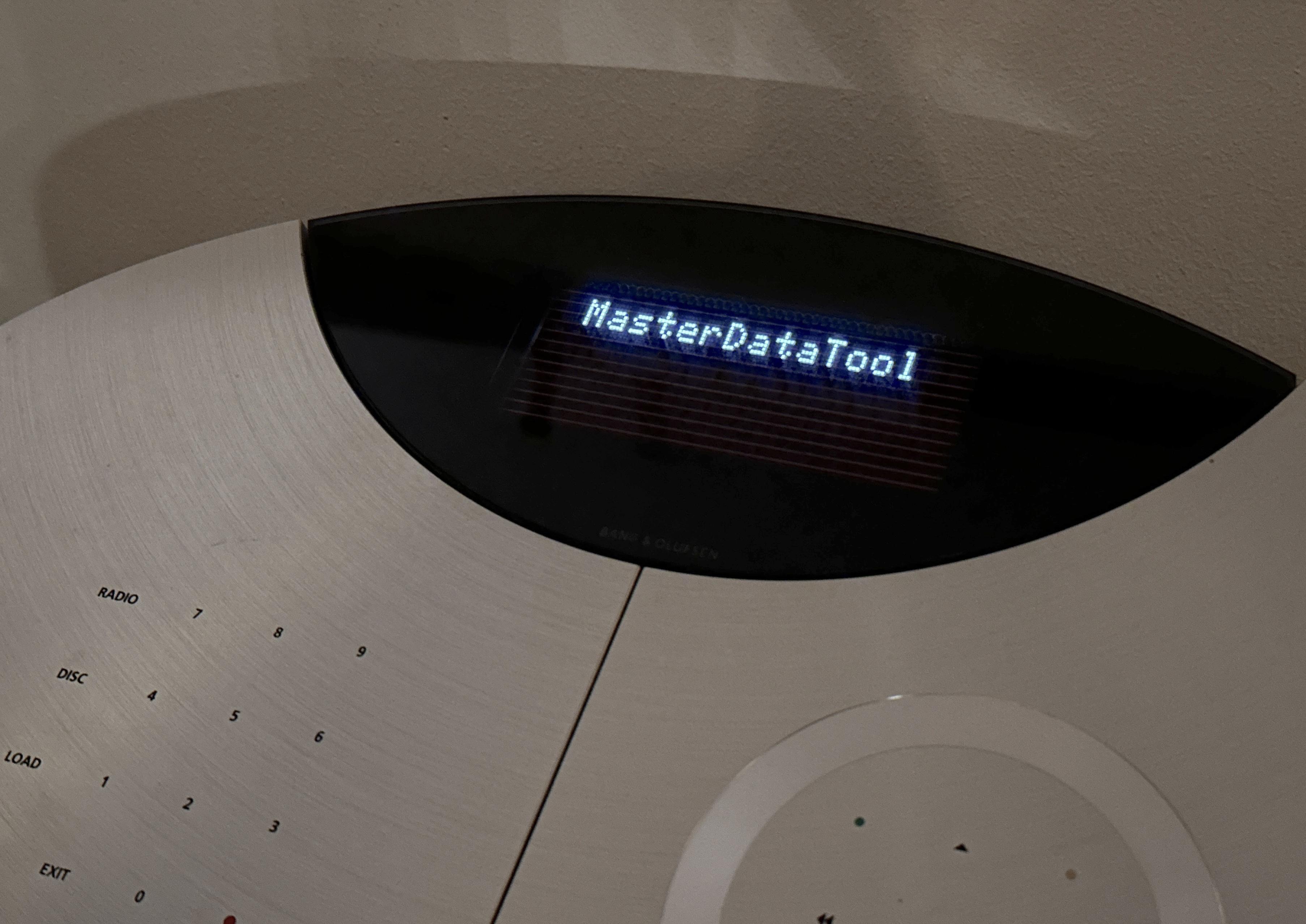

    One of such cool things attached. Will later show the the title info from Spotify / AirPlay / etc.
