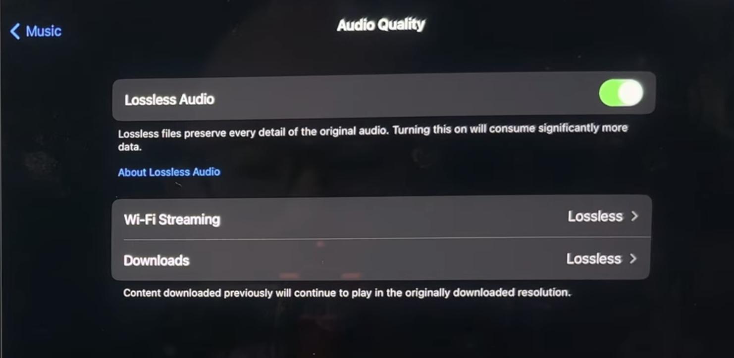

Location: Flensborg————Danmark26 November 2023 at 12:37 #50751GOLD MemberFurthermore….those concerned about audio quality should know that one has to change this setting in Apple Music to ‘on’ – by default it is ‘off’.
Otherweise it won’t matter, whether you use a wired or a wireless (AP2) connection or not.
