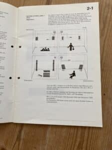

    I recently bought this System manaul 1987/88 – Beolink as I was interested to see what that that was about.
     It is in german, but I can understand enough (with a little help from Google translate) to figure that it is kind of like the later Master Control Handbooks (and Masterlink Handbooks for that matter).
    But that got me thinking, how many of these kind of systemmanuals / Handbooks was there? Was a new one coming each year or only if larger changes in the product programme and link technology made it nessecary (probably)?
    To get a little wiser I have tried to make a list of the system manuals and Master Control Link Handbooks that I know exist in the next post , and then maybe others can chime in with info about other versions and I will update the list accordingly.
    As with many manuals from B&O there is not a clear indication of publication year/month/date, so I have tried to make an indicative publication year for each manual based on the naming and/or information in it.

    System Manual 1987/88 – Beolink (~1988)
    In the preface of the manual it is mentioned that it gives a complete overview of the Beolink systems and Master Control Link 2 systems from bang & Olufsen.
    The system manual specifically mentions the following products:
    MCL2A (type 2045)
    MCL2B (type 2005)
    MCL2C (type 2009)
    MCL2E (expander type 2007/2008 )
    Beomaster 3300
    Beomaster 5500
    Beocenter 9000
    Beovision LX2500/2800
    Beovision LX2502/2802
    Beocord VHS 91 / 91.2
    Beocord VHS 82 / 82.2
