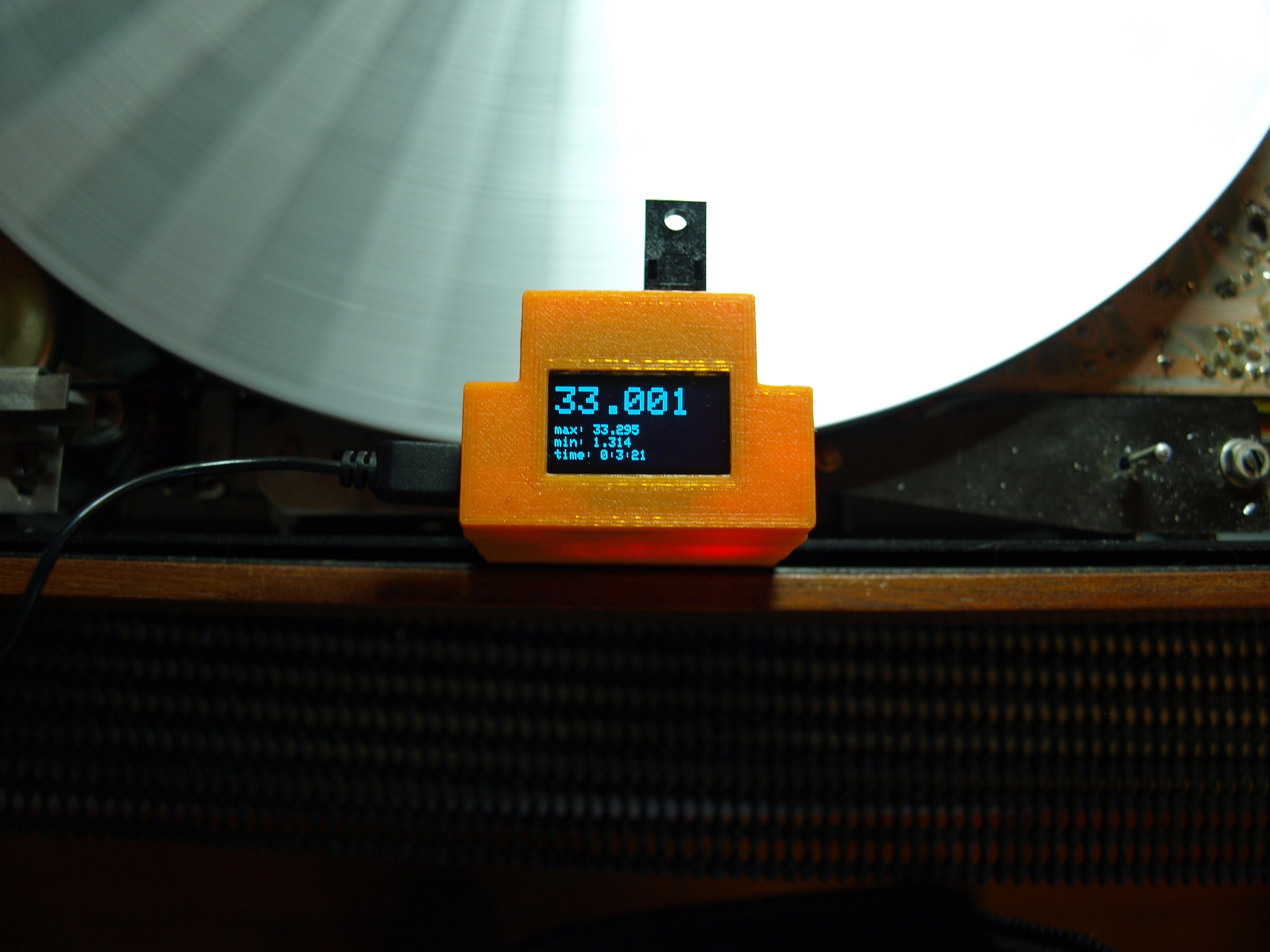

30 December 2023 at 14:47 #51202
hcraig244
SILVER MemberSo tweaked it in……..

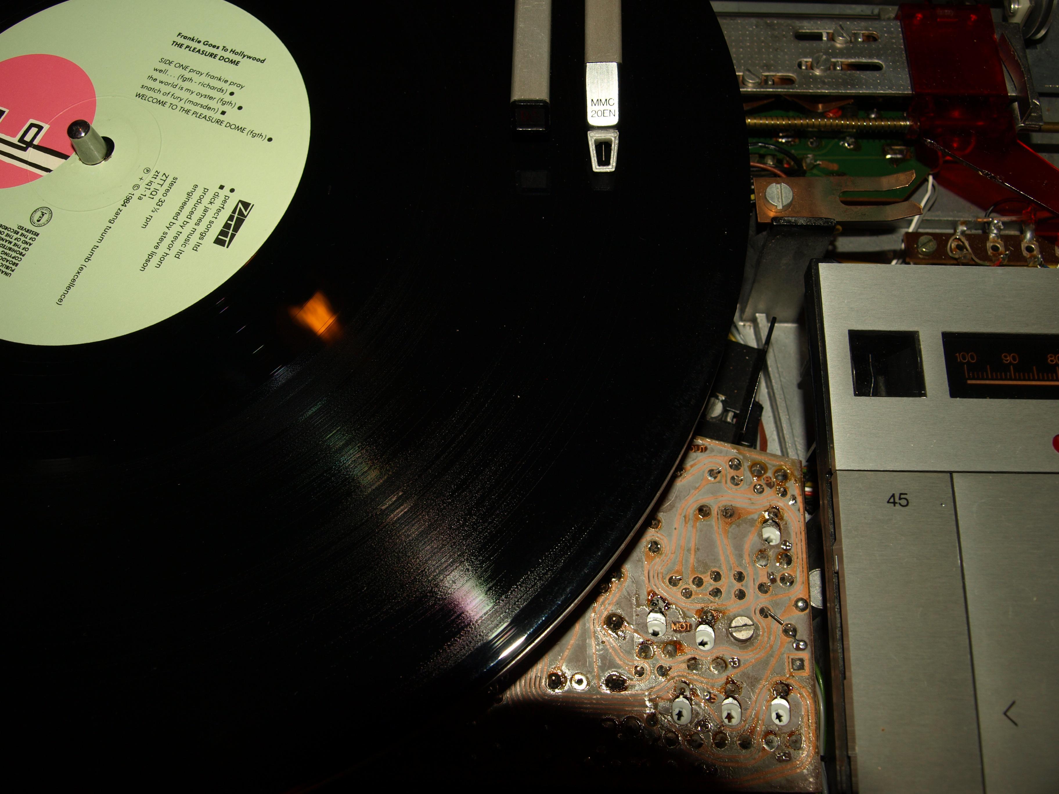

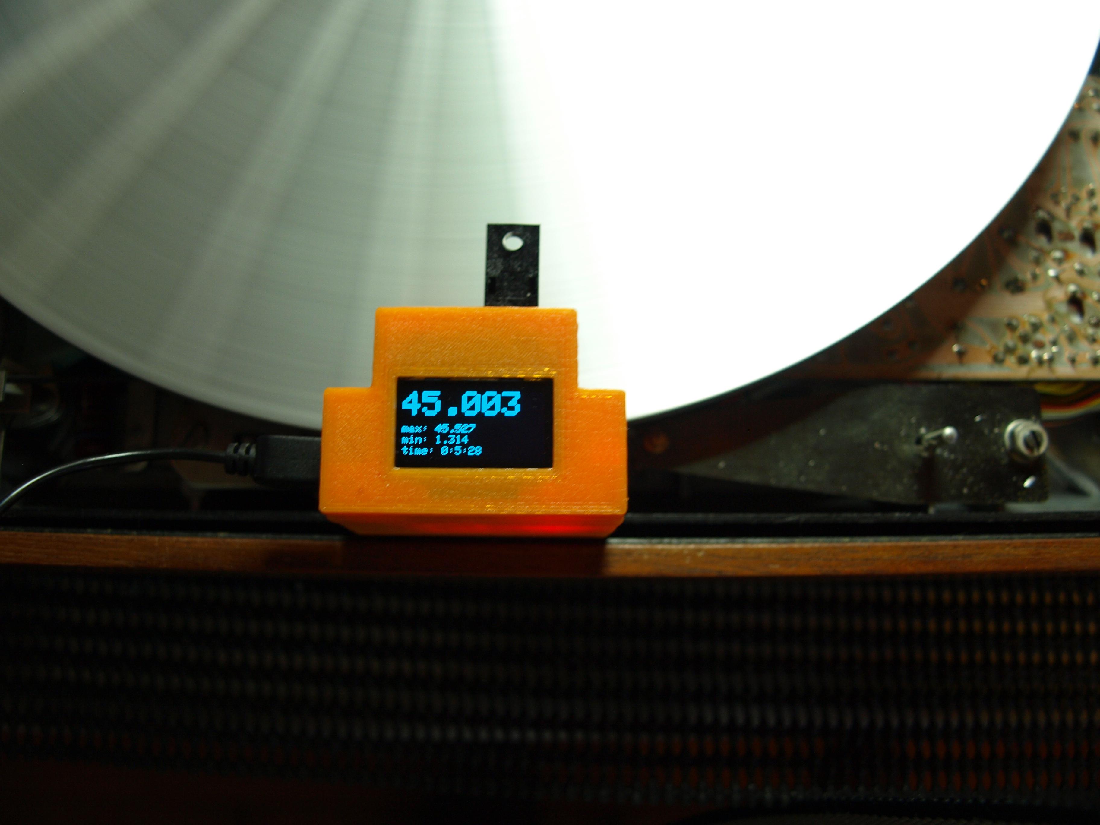

30 December 2023 at 14:49 #51203hcraig244
SILVER Member45rpm was a similar story….tweeked that trimmer also

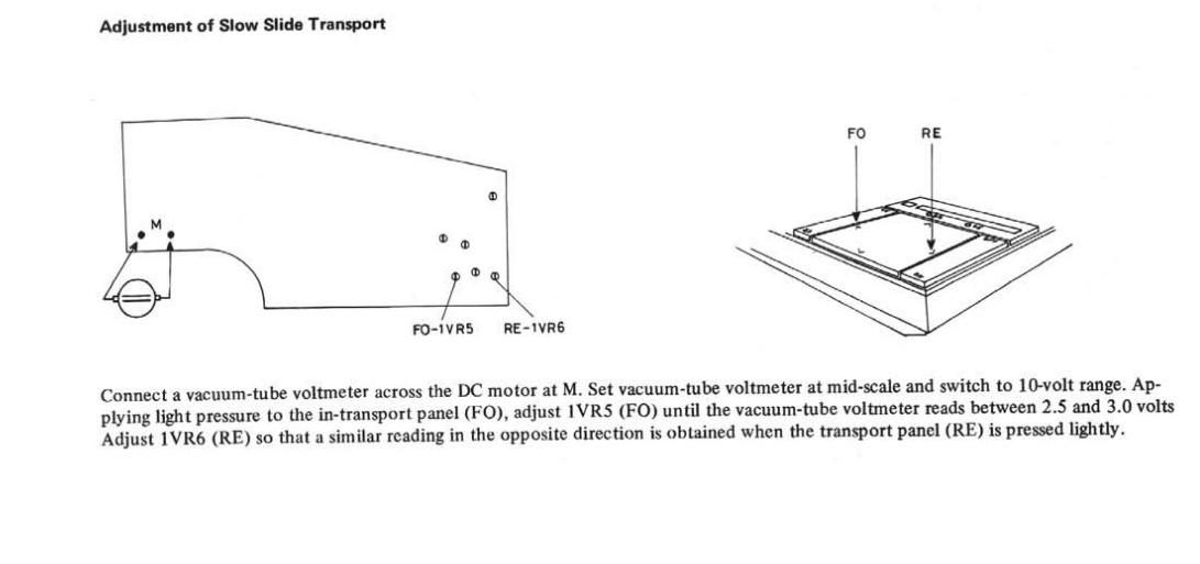

SILVER MemberAdjustment o the slow slide transport……..

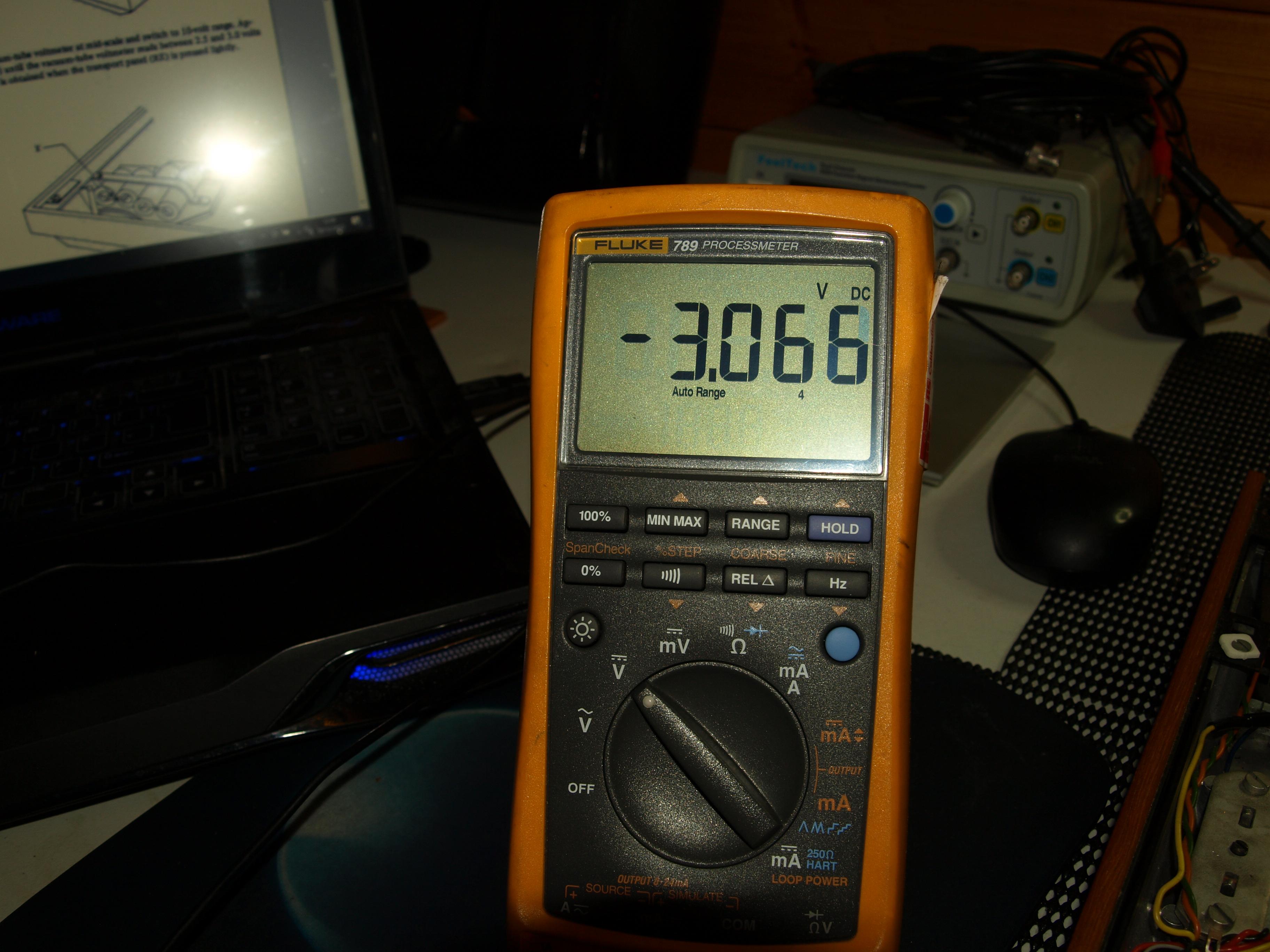

30 December 2023 at 15:15 #51205hcraig244

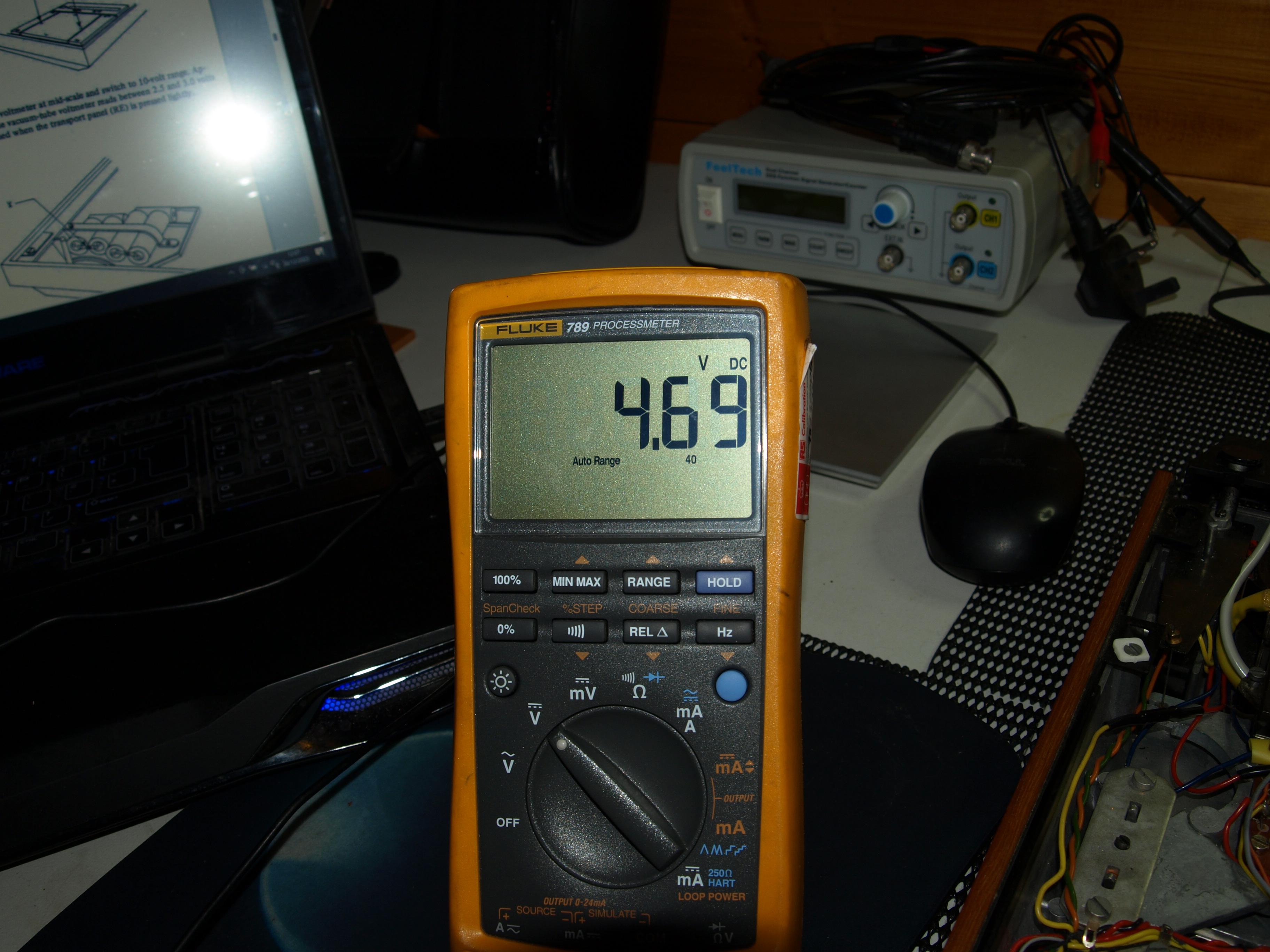

SILVER MemberThis went well……forward measurement, got the probes wrong way around naturally, measured up fine
30 December 2023 at 15:17 #51206hcraig244
SILVER MemberReverse was a little off….so had to adjust somewhat, so its always good to check. oh and swapped the probes around.

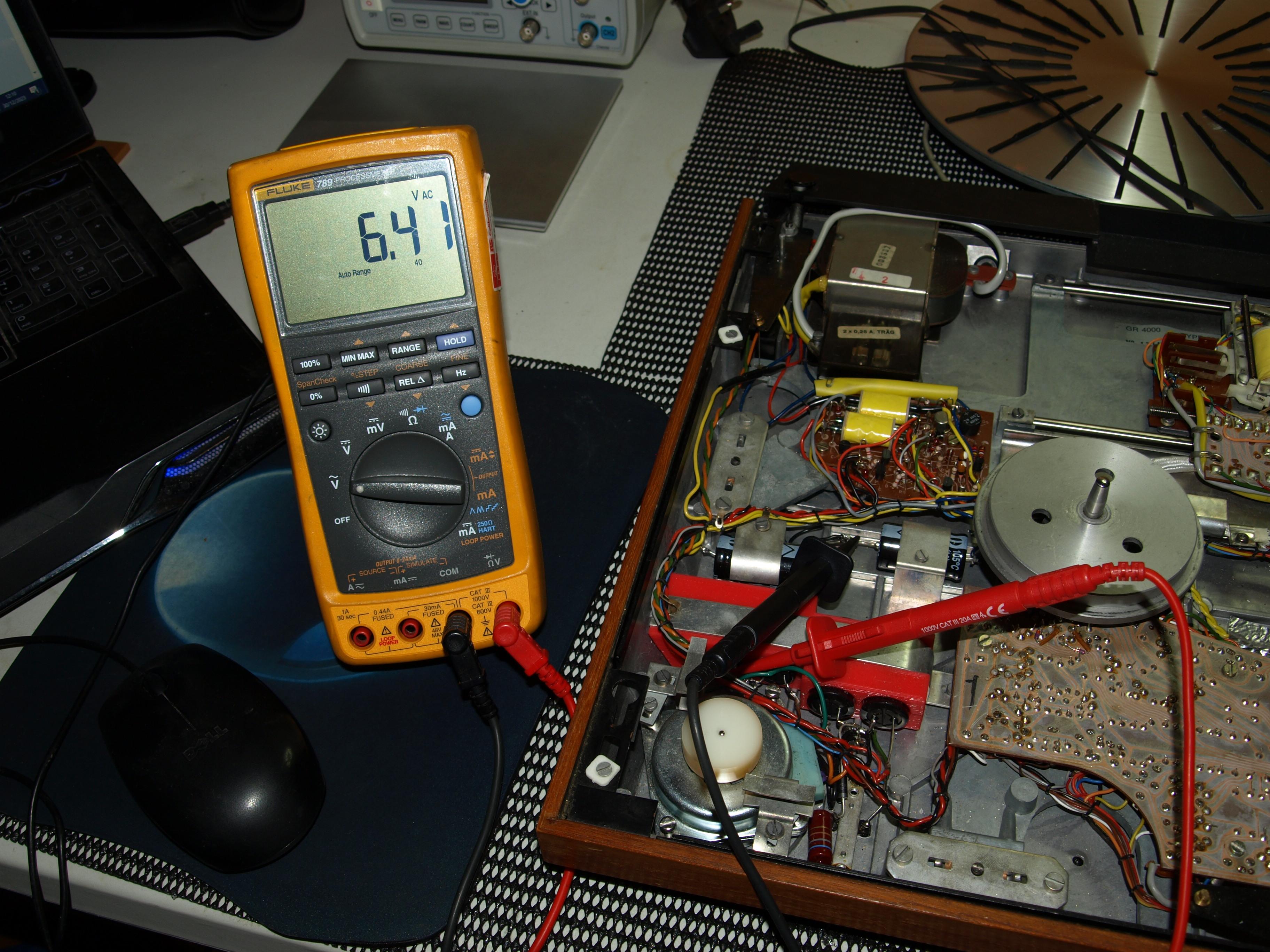

30 December 2023 at 15:41 #51207hcraig244
SILVER MemberAdjustment of voltage for drive motor
30 December 2023 at 15:48 #51208hcraig244
SILVER MemberFairly straightforward with the exception that X is now in a different place due to the modified capacitor arrangement provided by Rudi….the Bi Polar capacitor position is now after the two back to Back capacitors…..measured up fine.

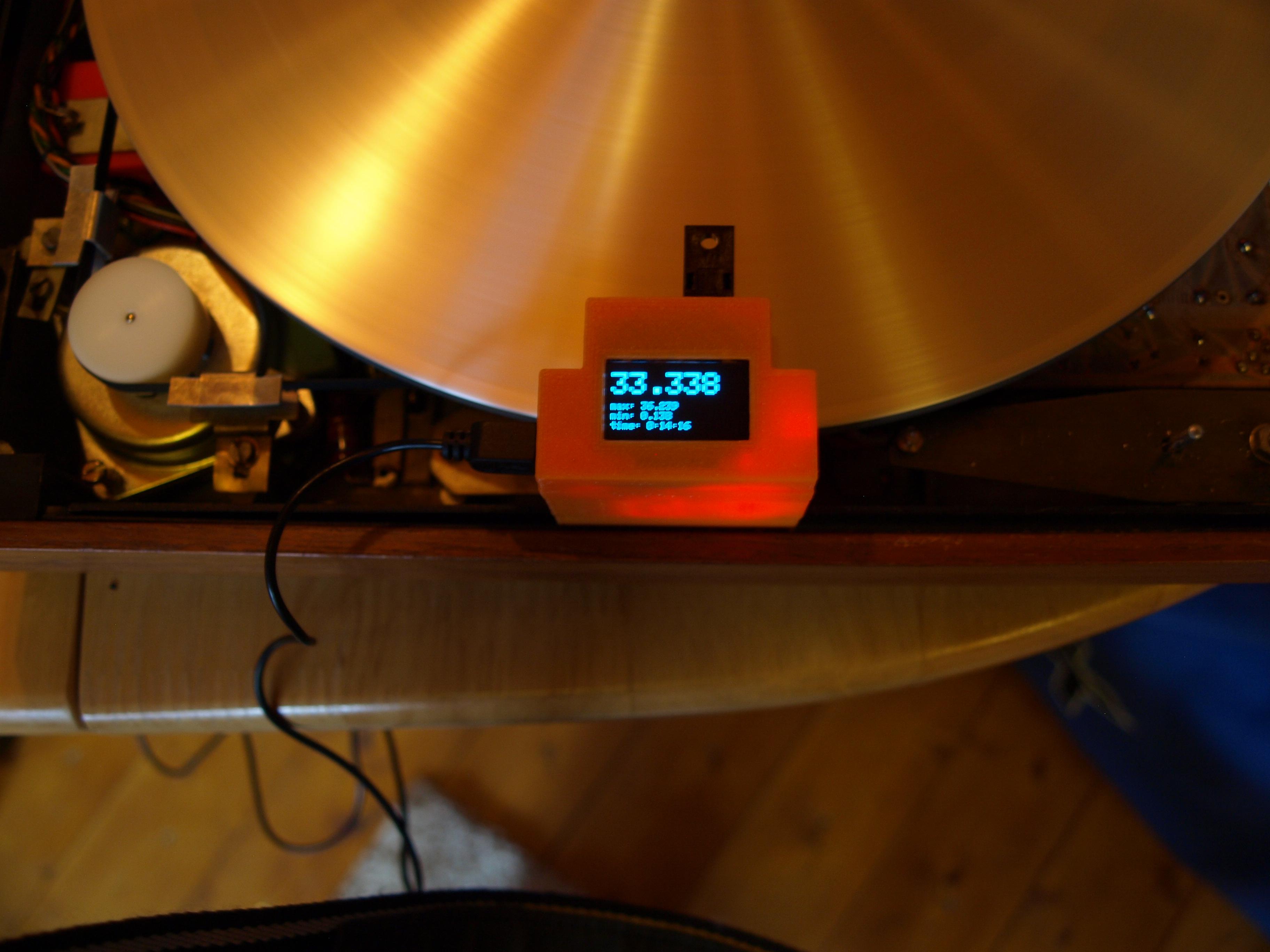

1 January 2024 at 11:02 #51210hcraig244
SILVER MemberWell……isnt this a little embarrassing, fortunately Glitch is paying attention and identified the schoolboy error regarding the 33rpm setting. should of course be set to 33.33rpm…the manual identifies the 33rpm setting should be set up using the stroboscope dial which no doubt is calibrated to give a 33.33rpm setting when appearing stationary…..oops

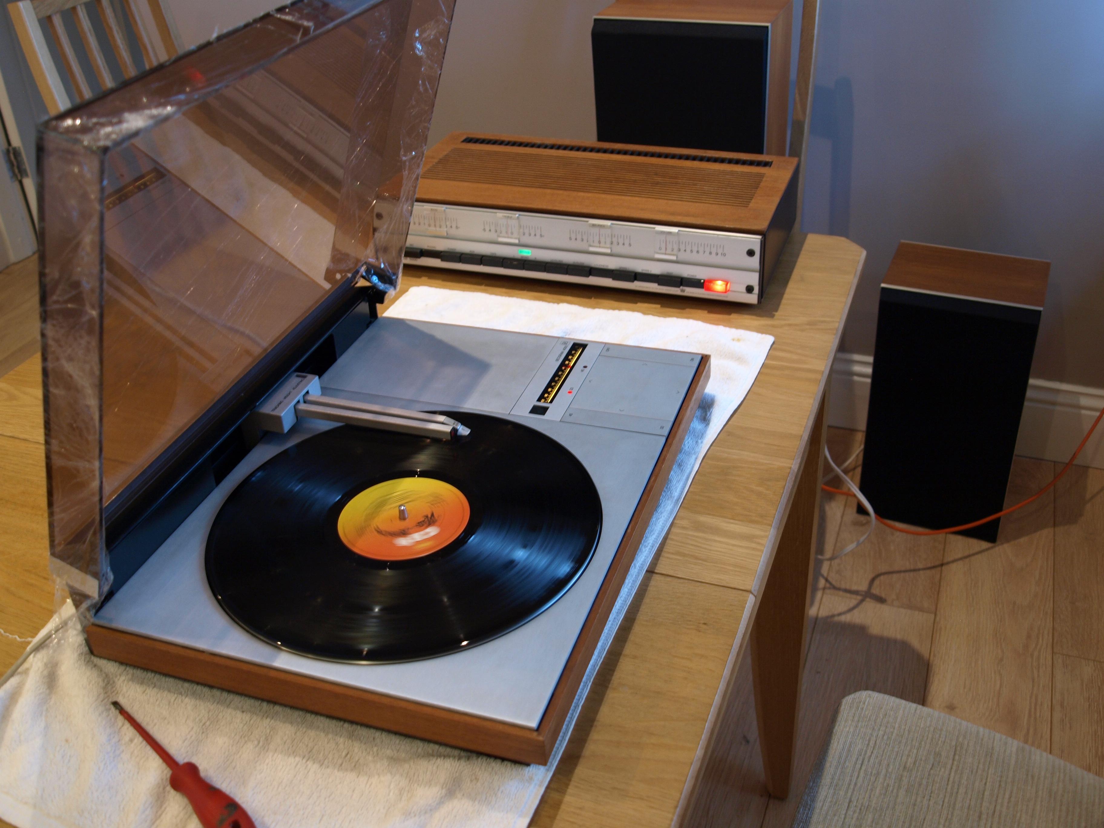

1 January 2024 at 11:05 #51211hcraig244
SILVER MemberQuickly moving on…….as the deck came to me bereft of cartridge I fitted one of my own and gave it a test

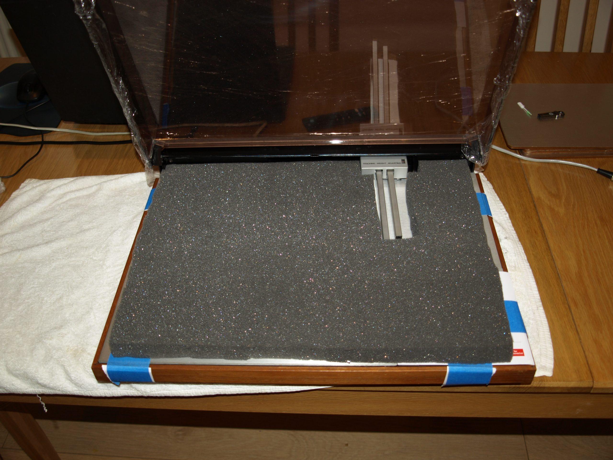

4 February 2024 at 12:00 #51214hcraig244
SILVER MemberAll done and ready to roll…..

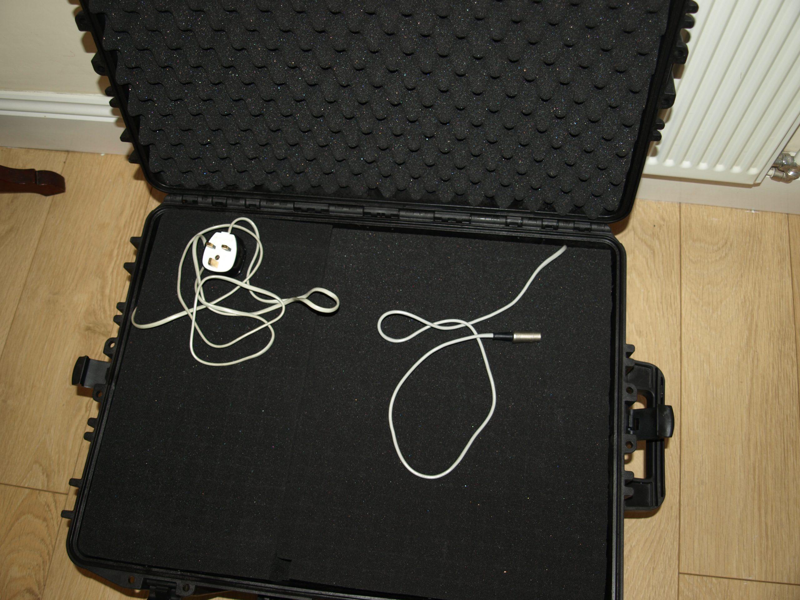

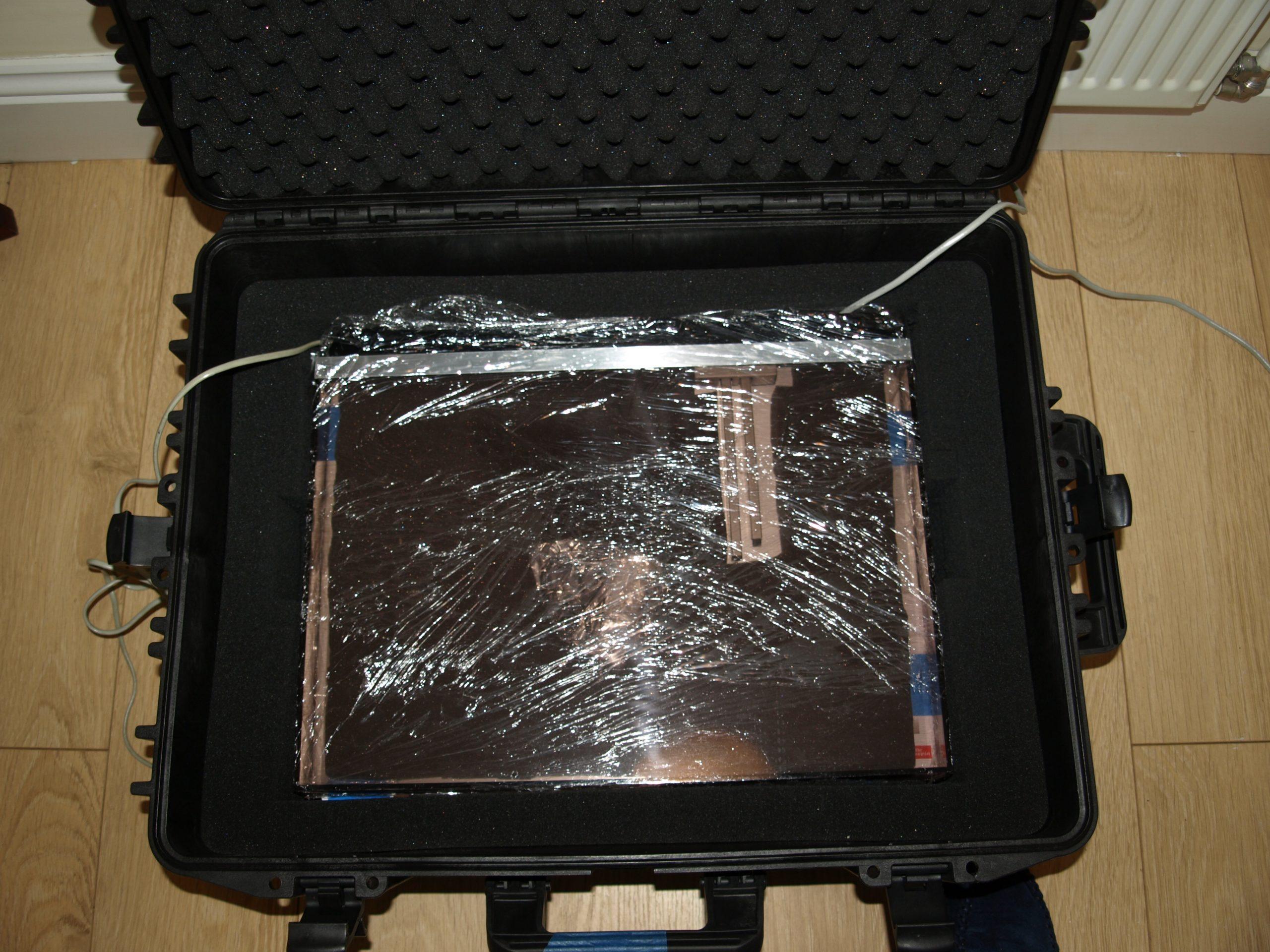

4 February 2024 at 12:01 #51215hcraig244
SILVER MemberThe strong box is ideal for transit…
