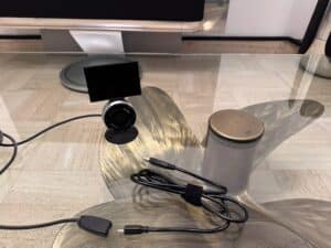

    Hi everybody
    I bought a used Beo 6. If the remote is in the charger the display is alive and I see the message “charging”.
    If I remove it the remote is out of battery. So I think the problem is the battery and I have ordered a new one.
    After I removed the connection puts I see a red cable that was installed from the pre owner soldered to the remote. Does anyone know what this could be?
    Second question, because it’s my first Beo 6, how can I connect it to my computer? On the second photo you can see the charger and the cable of the power supply-
    Any help will be appreciated.
    Thanks

    For the 2nd, connect a USB to mini USB cable to the charging base.
    I assume that you have already installed the configuration tool on your PC.
    Attached a very useful guide written by another Beoworlder, I hope it will help you.
    Note that it is VERY important to have the Beo6 fully charged before downloading the file created in the software to the remote.

    Thank you very much for your answer and the BEO 6 Configuration Guide. That will help me a lot.
    I also find the right cable to connect it to my computer.
    Next step is to see how it works with the new battery next week.
    Perhaps someone else can help me with my first question concerning the red cable.

    I received the new battery yesterday and charged it overnight. I can then enter commands for about 20 seconds
    and then the control remote switches off (Message on display “recharge battery).  I have removed the red soldered cable.
    I don’t know how I can remote my B&O Ouverture. The first screen shows me  “Zones Standard” .
    Perhaps someone has an idea to fix the problem. I have attached 2 photos.

    Thanks for your help. I now soldered the red cable and try again if the Beo5 will charge.
    If not, I will sell it with the technical defect on Ebay. Perhaps there is someone who can
    fix it.
