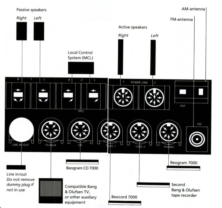

How are the MCL connected to the T1611? If you try to connect MCL directly to ML then for sure you will end up in problems.
The T1611 is designed to connect non-ML Audio or Videomasters to a ML Video or Audiomaster. So in your setup to connect a BM7000 (non ML Audiomaster) to the BV7 (ML Videomaster).To my knowledge your set up should be:
BV7 – ML connected to T1611 – Data en Powerlink connected to your BM7000
BL3500 is parallel ML connected to the BV7
Both MCL2A’s are parallel connected to speaker 2 of your BM70001 September 2025 at 17:28 #69283lenhi

Powerlink: is the connection from Audio or Vidiomasters to send audio signals (left and right in the same cable) with (opptional) communication info to the amplifiers of the active B&o speakers; Beolab (8pin plugs). The way you connected your Penta’s to the BV7.
Datalink: is the connection including communication, between sources such as CD players, record players, etc and Beomasters/Beosound; but also direct connection between Beomaster/Beosound and Beovision (7pin plugs). The way the Beogram 7000 or Beogram CD 7000 is connected to a Beomaster 7000 for example.The MCL socket should be the same as the Speaker 2 connections of the Beomaster 7000. Could you indicate were they are connected?
The T1611 is also connected to your BM7000 I presume? How is it connected?
There are no speakers connected to your Beomaster 7000 (just to be sure)?
