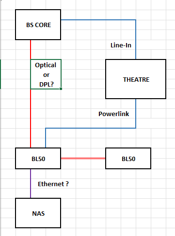

24 August 2023 at 10:48 #48219 YannChrisGOLD MemberHello Geoff,
Thanks for your explanations.
I’m waiting for delivery of Theatre and BL50 to replace my Eclipse + BL.
My setup also include a BS Core and a NL/ML converter connected to ML products.
I’m wondering what would be the way to connect the products in order to have the best quality when listening to music.
May you give me your advice on the alternatives shown below:
1 – Core to BL 50 via optical (Limited to 24/96 birate)
2 – Core to BL50 via Digital Power Link hoping it can support 24/192 bitrate (there is one DPL socket on the Core and 2 on the master BL50),
3 – NAS to BL50 via Ethernet.
A side question: What would be the best way for calibration: run BL50 first then Theater or run Theatre first then BL50?
Thanks and kind regards,
Yann

24 August 2023 at 12:54 #48223NQVHNWI
BRONZE MemberJust some comments here if I may?
1. Im not sure you can connect the NAS to the BL50. The BL50 has no rendering capability.
2. The NAS just needs to be connected (somewhere) to your home network. As does the Theatre and the Core. Because of DLNA, both the Theatre and the Core will “See” the NAS
3. On the same basis, you dont need to “Line-in” the core to the Theatre, and its probably better you dont?
4. Further, I do not why you would need the Core if you have the Theatre. I think, based on the information supplied…..it is superfluous?
24 August 2023 at 12:58 #48224geoffmartin
BRONZE MemberHi Yann,
Some things need clarification:
- The DPL connection on the Core does not work.
- I don’t know how you would connect your NAS drive directly to Beolab 50s – and you certainly can’t do this via Ethernet. You would need some kind of network streaming device between those two things.
- This leaves you with 4 options
- Core->BL50 via Power Link
- Core->BL50 via Optical
- Core->Theatre via analogue -> BL50 via Power Link
- Theatre->BL50 via Power Link
As you mention, one reason to put the Theatre in the chain is to have the additional room compensation if you wish. However, it may also be preferable to rely only on the Beolab 50s Room Compensation and to not do additional compensation using the Theatre. This is also an issue of personal preference. If you choose to include the Theatre in the chain, you should make two Listening Positions in the Theatre that are identical apart from the room compensation filter and make this decision yourself. To answer your specific question: Calibrate the BL50s first.
As I (hopefully) explained above, there’s no way to answer to your question… And, it should be said that any possible audible differences in audio “quality” (I put that in quotations because we’re really talking about personal preferences) may be outweighed by other factors. These include things that have nothing to do with the audio signal flow such as your preference for user interface (e.g. you can control the Theatre directly from its panel on the top) or power consumption (three devices use more electricity than two…)
The one thing that I will definitely recommend is that you keep a wired connection between your two Beolab 50s rather than connecting them with wireless, since this has an impact on the room compensation within the loudspeakers. The side-benefit of this is that you can control the loudspeakers directly in the B&O Application if you’re sending a signal to them on the optical input.
Cheers
-geoff25 August 2023 at 15:49 #48225 YannChrisGOLD MemberHi Geoff,
I may have been unclear in my post, so here are some more details:
1: In my mind, best quality is seen on the technical side and means to minimize conversions/filterings made on the signal path and have the necessary ones done by the most efficient product of the setup (BL50).
2: My project is to have a sort of 2 in one system: one for TV and casual listening through the Theatre/BL50 combination and one for “active listening” using the best quality defined hereunder.
3: Music files are stored in a QNAP NAS connected to a router dedicated to A/V (as recommended by B&O when I bought a Moment) with Core, Eclipse, NL/ML converter, all wired.
In the 4 options you mentioned, the second seems to be the most adapted but unfortunately the Core is limited to the 24/96 bitrate, when BL50 supports 24/192.
I agree, this is a personal “snakeoil” approach but I like to use the maximum of what a product can offer.
I totally agree with you when it comes to wired connections vs Wifi. I plan to connect the master BL50 through Ethernet and use DPL to link master to slave.
Kind regards,
Yann.
