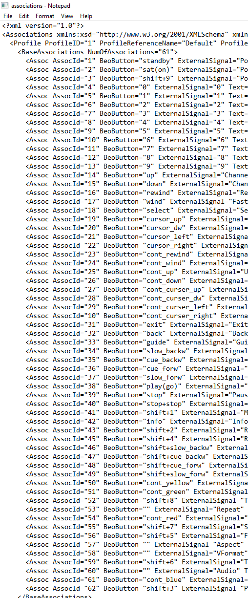

    Hello, has anybody been able to create a custom PUC so that it works with 3rd party devices?
    I’m half way there and I was able to control the Nvidia shield pro lately but there are keys that are mapped on the beoremote one that I don’t understand what they do.
    I have the IR codes of one the remote control I’m trying to integrate with my Beovision but the key association is a bit misleading. Any support is appreciated.
    6f2932949b814bda8ce2766e4e28cbad
    The numbers, cursor and back buttons are working however the Blue/green/red and yellow dots are not.
    Red dot should be cont_red but it looks like it’s not…. Also what’s exactly Shift+1/2/3/4/5… on the beoremote?
