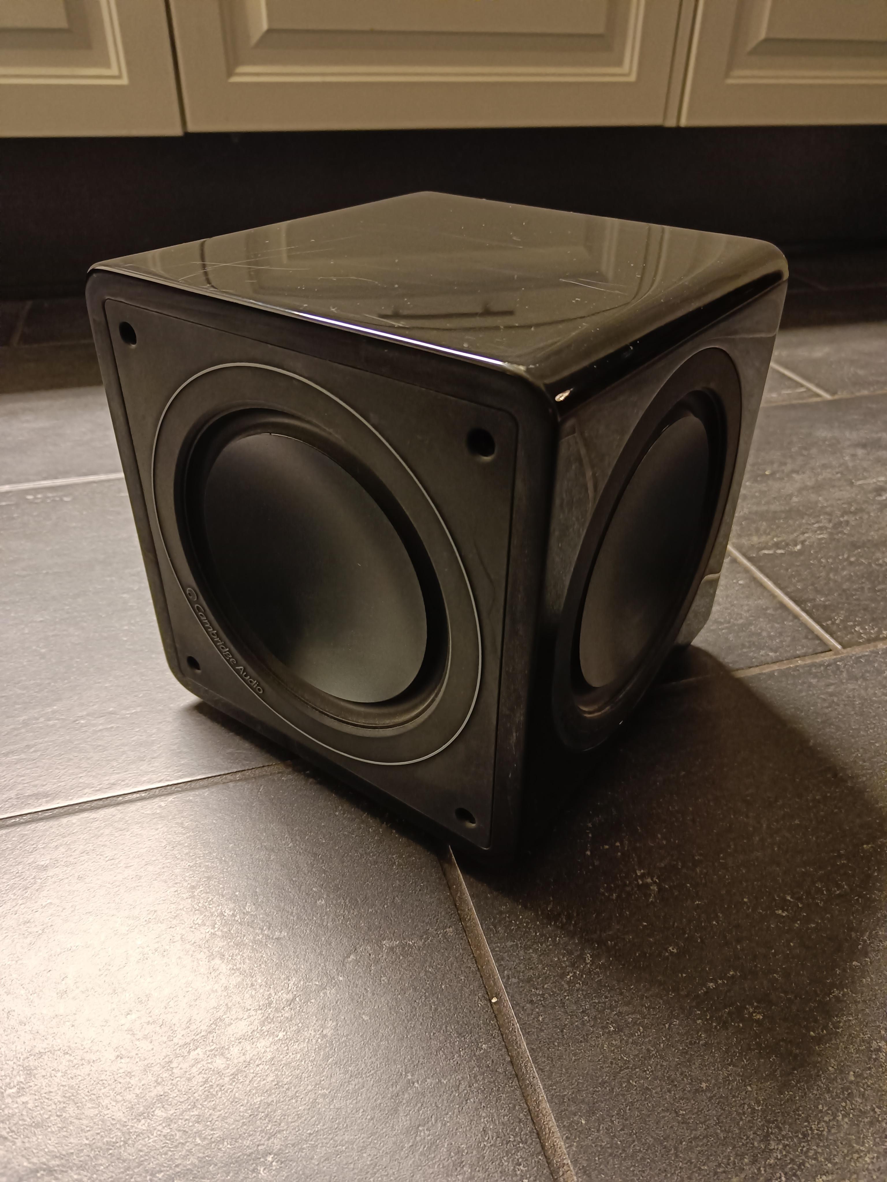

    I never had the 11. I combined my 3’s with Cambridge x200 sub instead. Gives much better options for tweeking. And it even looks similar to the 3’s. (Esthetic wise)

    Ravsted
    X200 / X201
    IMG20230728222704IMG20230728222734
